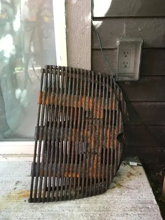

Accidentally left grill grates outside during the winter and rust built up.
Tried to search online and ask at Lowe's, but didn't find a good solution.
What worked for you?

Put them in the grill and get them HOT! Then use a wire brush and scrub the scale and rust off. After that I usually coat them with olive oil but any cooking oil will work.

  • I tried a couple of methods from other answers, but this one eventually did the job. I heated them up in an oven to 550F and then used a wire wheel and power drill to scrub the rust off. Then oiled them like you recommended. The grates are like new now. – Nikita R. Aug 15 '17 at 21:16

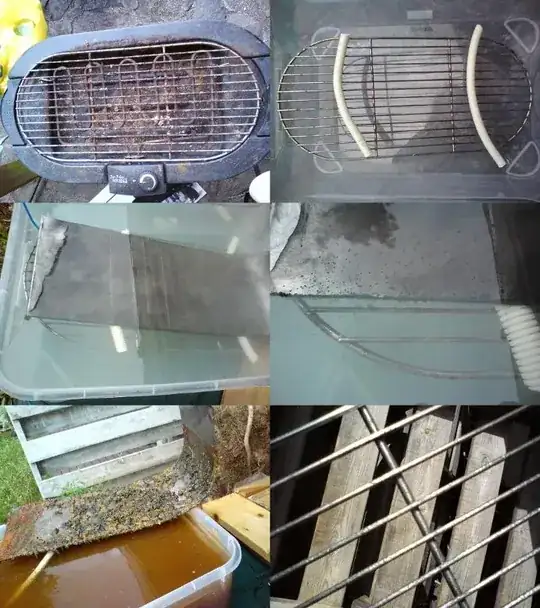

Excellent electrolysis results:
You need:
  • One rusty grill grate.
  • A plastic container.
  • Some DC power source.
  • An iron plate (NB pure iron, NOT stainless steel!).
  • Sodium hydroxide, NaOH (alternatively sodium carbonate, Na2CO3).
  • Rubber gloves.
Instructions:
Put the grill grate inside the container making sure that it is not lying flat on the bottom but have room for fluid to move under it, place some stands under it if needed.
Place non-conducting thin spacers on top of the grill grate and put the iron plate on top of that (e.g. parallel but not touching). Connect correct electrical wires to each of the grate and the plate.
Put on the gloves (safety glasses are also a very good idea), mix sodium hydroxide and water in a bucket (warm water dissolves more quickly), and pour the liquid into the container, repeat if needed until fully covered.
Turn on the power source, it should start to bubble a little and you see rust being generated. Let it stay until done. You might need to clean the iron plate from time to time (although if you do not the process only goes slower).
When done, take out the grill grate, dry it and brush it with a wire brush and enjoy your almost as good as new grill grate.
images of electrolysis process
The above is just the general instructions, look up a couple of the hundreds of tutorials on rust removal electrolysis available on the internet for details.
From the pictures you see that I got hold of a quite large iron plate. It is not strictly needed to have one that fully covers the grill grate, but it will ensure even coverage (with uneven coverage just move the anode around over time or just let it run longer). Concrete reinforcing rods are an alternative. Using graphite instead of iron as the anode is a better solution as it avoids making the liquid so messy, but I have not tried it.
The waste from this should be safe and non toxic, but check with your local authorities for disposal. And again no stainless steel! Also avoid copper wires inside the solution.
