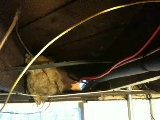

I noticed a good sized hole in an exterior wall that allows wires and things to go from my AC unit into my basement.
The problem is that the hole is a good deal larger than it needs to be and there is nothing sealing the hole, so I can see sunlight clearly through the hole.
What should I use to fill this hole in my wall preserving the important stuff going through the hole?
Click for full size
hole in the wooden exterior wall

I would use Duct Seal
I'm surprised whoever installed the AC unit didn't use it, it's used all the time by Electricians and HVAC technicians.
It does not harden; so unlike foam, it can be easily removed and replaced if you have to add/remove wiring/plumbing.

Usually all that is needed is a good outdoors silicon caulk. You can get a clear type or a paint-able white type.

    "Do your best and caulk the rest!" – auujay Feb 03 '12 at 22:39
  • I like 'great stuff' for this sort of application. try the 'doors and windows' version. – Trout Feb 03 '12 at 22:58
    Foam gap fillers (like Great Stuff) are very useful but are not the best way to seal exterior surfaces, because they break down faster when exposed to sunlight and/or water. An exterior-grade caulk is the way to go for a longer-lasting seal. – Shimon Rura Feb 04 '12 at 07:10
  • Painted Great Stuff last much longer. – Bryce Sep 05 '12 at 07:57
