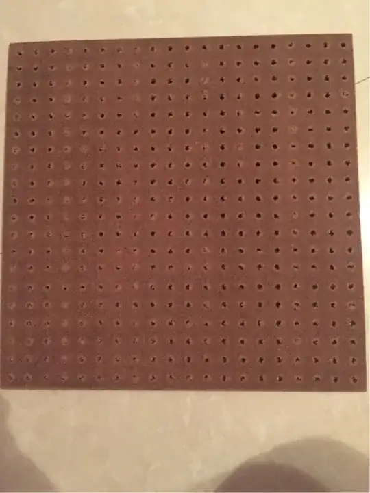

I was hoping to find a white surfaced perforated board that could be used as a peg board above a home/ office desk for organising things in a flexible way. PS: not a garage desk with tools.
I wondered if it should be painted (what kinds / how) or it could be coated with white coating sheet (paper or plastic/ vinyl kind of sticker / sheet)

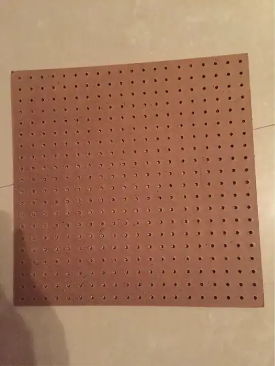

I'm sharing a front & back pic of the board sample. Actual full size is 4 x 4 feet.
Thoughts/ suggestions/ options / Pros & Cons?
Front front
Back back

Pretty much any paint that's suitable for wood will work fine, though it will absorb a bit more readily. You'll get some raised grain with the first coat, so plan on hitting it with a sanding sponge or similar after, then let it dry well before you recoat to prevent excessive swelling. A sanding sealer might be a good idea to start if you don't mind buying multiple products.
Overlaying adhesive sheet isn't a great idea. It won't bond well and you'd have to punch out all the holes. They do make a white melamine-coated pegboard, though it sounds like it might not be available to you.
