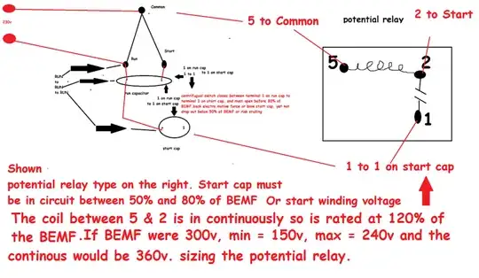

The Compressor has 2 winding's, a Run winding and a Start winding, the Common terminal is the point at which both of the compressor winding's connect, thus the "Common" designation. For example,say you read 3 ohms resistance for your Run winding (Common to Run), and you read 5 ohms resistance for your Start winding (Common to Start). This means between the Run and Start terminals you SHOULD read 8 ohms, as Run to Start is reading both winding's resistance in total, if they do not jive then one winding is shorted to itself or ground or the other winding. This is a good indicator of whether a compressor might have a shot at running if you send power to the compressors Common and Run terminals.
The Run capacitor is wired to the Run and Start terminals of the compressor, the Run capacitor stays in the circuit full time, however the Start capacitor only stays in the circuit for at least 50% yet no no more than 80% of the Start winding voltage or BEMF, back electromotive force.
BEMF is above the line voltage feeding the compressor, say it's 230 volts, the Start winding may read 300 volts, this is due to a motors similarity to a generator and the motor actually is creating voltage above the line voltage applied. To read BEMF you "bump start" the compressor by touching the Start capacitor's terminals to the Run capacitors terminals briefly!! too long and the Start capacitor will explode, too little and the compressor stalls. So after the compressor starts up rerad the Start winding voltage, we said it was 300 volts, so to size the potential relay that controls the Start capacitor we take the 300 volts and x .50 = 150 volts minimum. Then take the 300 volts x .80 = 240 volts maximum. You will want a potential relay that drops out no lower than 150v yet stays in no longer than 240v. And for the Continuous rating we take the 300v x 1.20 = 360 volts Continuous.
So 150v min & 240V max & 360v continuous.
A capacitor adds a pulse of power in the East and West poles while the line voltage is feeding the North and South poles of the motors armature, in effect its adding torque by having 4 guys spin the merry go round rather than just 2 guys if that makes sense.enter image description here
