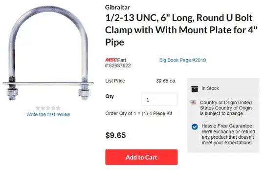

That is the mount(ing) plate for a U-bolt,
like this:
u-bolt with mount plate
batsplatsterson
