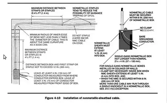

Staple romex as specified by code:
Staple Code
