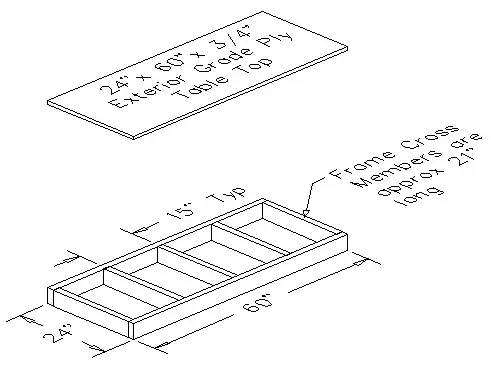

Take a look at these Standardized Work Table Plans as it might give you some ideas. Obviously you would not need the lower shelf, but otherwise it would be similiar (but scaled down), and this thing can hold a lot of weight!
Table Top Design

  • thanks, it is nice. however I would like to avoid using 2x4s as they consume too much space...Would it work with 2x3s or 2x2? – Alex Feb 08 '12 at 20:46
  • I think the key with a plywood top is just ensuring its adequately supported below so that it does not sag and crack. If you are worried you can space the supports closer together while going down in size. – Steven Feb 08 '12 at 21:04
  • Based on @Steven design, I would probably add chain going from the corners opposite of the wall, at 45 degrees, connected to the wall using some sort of eye bolt and washers (making sure to hit the frame in the bench and studs in the wall). If there's no support for the bench below, and your friends being on the bigger side, you'll need something to support the weight and not rip it from the wall. That would leave the below perfectly clear for shoes and storage. – lsiunsuex Feb 09 '12 at 12:11
