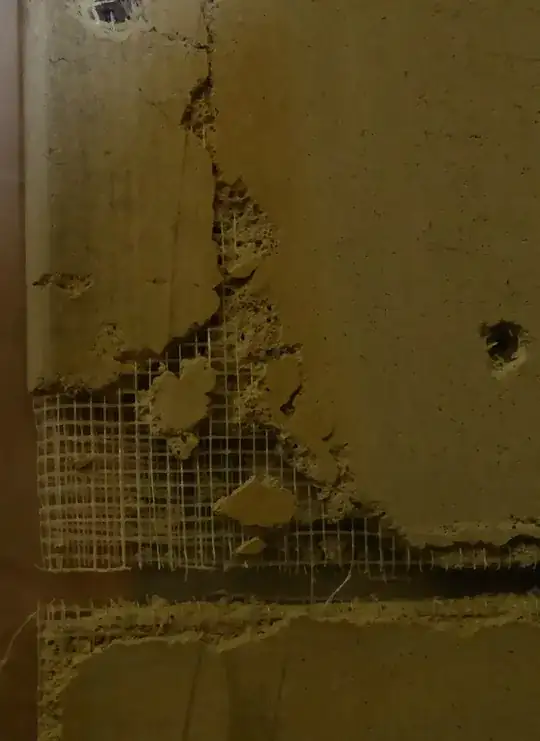

  • @noybman there is no roof vent there are AAV on the soils stacks. I have look in the attic/loft for the top of this one and it appears to not even go that high i'm guessing it's behind a fake section of wall in the kitchen. – Matt Stephens Aug 18 '17 at 09:26

  • I've tried locating the top of this soil stack and it appears that it's behind a fake section of wall, having looked in the attic/loft it doesn't appear to reach that high which means to access the main stack AAV i'm going to have to remove a section of the fake wall. – Matt Stephens Aug 18 '17 at 09:29
  • In that case, if I were the building manager, I'd choose the path of least resistance first, and check the lower apartments first. It's possible you are the only tenant with a vent, at this juncture. – NPM Aug 18 '17 at 11:07
