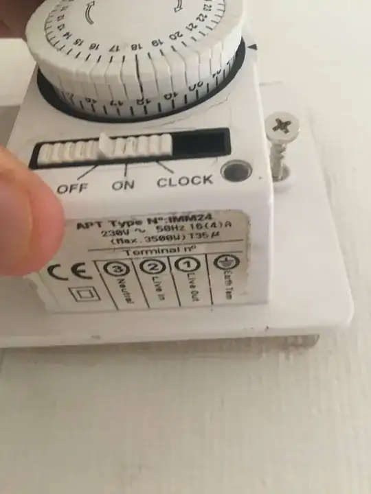

I just replaced my old thermostat and timer for a Google Nest, but every time I turn the electricy back on, it goes off shortly after. I have an oil boiler for heating.
Before I call an electrician, what could be the problem? How can I troubleshoot it?
I'm looking for guidance more than for a straight answer if that's possible.
Thanks!enter image description hereenter image description hereenter image description here

  • Added photos, the timer has 3 cables (1 2 3) that were connected to the nest using the attached scheme – Antonio MG Aug 20 '17 at 14:43
  • Behind the rectangular panel was a themorstat that I removed, leaving only the timer – Antonio MG Aug 20 '17 at 14:43
  • per the diagram, you wired the Timer "Neutral" wire to Nest "N" and the Timer "Live In" wire th Nest "L" then Timer "Live Out" to Nest "3" and a second Timer Nuetral wire if it was there, to the "N"? The "L" for nest also jumpers to "2"? (Is this how you had it) – noybman Aug 20 '17 at 14:51
  • Neutral to N, live in to 2, live out to 3, jump between L and 2 – Antonio MG Aug 20 '17 at 14:52
  • That appears to be line voltage timer. Nest is 24v – Tyson Aug 20 '17 at 15:03
  • Sorry Tyson, what do you mean, have I connected something wrong? – Antonio MG Aug 20 '17 at 15:09
  • It seems you connected it the way the diagram suggests. Do you have a multi-meter? Also, have you re-verified the system works with the old timer back in place? Did you potentially jumper 2 to N? The photos of the wires you have to work with will be tremendously helpful – noybman Aug 20 '17 at 15:19
  • I will try again later and I'll take a picture of the nest connected. The old timer is back and working fine. – Antonio MG Aug 20 '17 at 15:24

The object in the photos is a 230V "immersion-heater timer". Most traditional UK heating systems have a "programmer" instead but I guess you could have an installation that just uses the timer. I'm assuming IE practices are similar to the UK.
In that case, wire 1 on the old timer would have provided switched-live to a 230V thermostat and the 230V thermostat would switch that live power to the boiler when needed.
If you just took the wires off terminals 2&3 on the timer and attached them to 2&3 on the heat-link, the heat-link would, when calling for heat, short neutral to live and trip the breaker. But I doubt you've done that because you wouldn't then have power to the heat-link itself.
I assume that you repurposed the wires that previously carried 240V live out to the thermostat and switched 240V live back so that these now carry 12V power to the Nest (as shown by T1, T2 in their diagram)? Presumably you disconnected any redundant wire(s) at both ends and made it safe (e.g. connect to ground at both ends).
I would turn off the breaker, disconnect the wire from terminal 3 of the heat-link, isolate that wire in a connector block by itself, turn the breaker back on and then carefully use a voltage tester to check that all the wires were as expected and that terminal 3 is initially dead (near 0v) but goes live when the heat-link/Nest realise that heat is needed.
