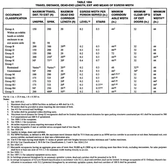

Here is a table from the International Building Code (modified for Florida).
Source
According to this the only egress doors that are required to be wider than 32", are Group I Occupancies.
Institutional (Group I) occupancies include buildings with occupants that are under supervised care, live in a controlled environment where they’re limited physically by either age or health, or they have personal liberties restricted by detention for penal or correctional purposes. Group I-3, which includes prisons, jails and correctional facilities, is further subdivided into “conditions.” However, unlike the occupancy subgroups, the 5 conditions are numbered with increasing risk to the higher numbers.
However, building codes can vary from location to location, and can be adapted by state, city, and town. To be sure what is used in your area, you'll have to contact your local government.
keep in mind that the 32" is the Minimum Clear Opening, so a 32" door may or may not be adequate.
