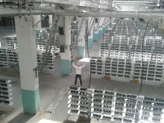

I'm trying to start a business in my house: Cryptomining. Essentially, I will be buying many big power-hungry computers which will print money out of thin air. It's a very lucrative business.
6000+ amperes of powa!!!
(source: coindesk.com)
Right now my house's utility supply is 200A 120v + 200A 240v, which is 72 kW 48kW total. This means I should be able to use ~32 kW for my equipment aside from all the household appliances. The equipment can accept both voltages and actually is more efficient on 240v.
Can the public electricity supply to my home be upgraded? The house is located in a development off the main road. The wiring runs underground for about 1000 ft. until it connects to the utility pole on the main road. So my guess is a solid "no".
I have considered renting a small warehouse and starting the business there. The problem is, most of the properties I find on real estate search engines (like Loopnet) only have 100 or 200 amp service. I need at least 120 kW in order for moving out of the house to be worthwhile.
What are my options? I know heat dissipation will be a big problem as well, but let's set that aside for a moment.
EDIT: My location is central New Jersey, U.S.A., and my house was built in 1998.
