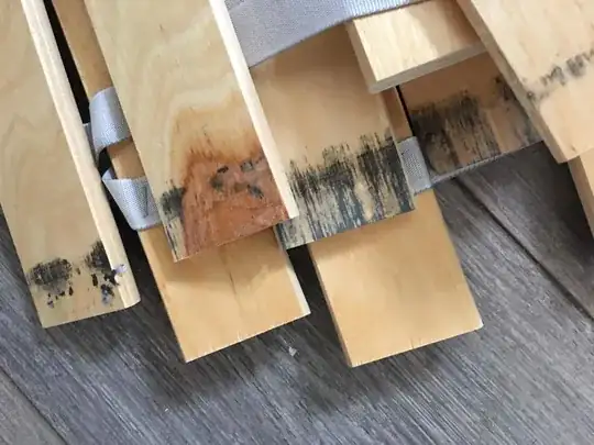

So the wood panels lay on top of the metal beams, it's a bed frame but I noticed these spots on the metal and rubbed them off and smelt like rotten eggs please let me know

Is this mold? Black? White?
Honestly, it appears to be simple iron staining. Appears black on wood, white on zinc coatings. Simple reaction of carbons in the metal and tannins in the wood. Although it is activated by moisture, it is not a mold, nor harmful.

    This seems a more plausible answer to me than the other one... – Fizz Sep 07 '17 at 17:54
    The steel marks (iron oxide stains) on wood can be [removed with acids](http://www.instructables.com/id/Removing-Black-Stains-in-Wood-Furniture-With-Oxali/) (or sanding) although it's hardly worth the hassle in this case. – Fizz Sep 07 '17 at 18:00
Yes, the wood (first picture) is iron-stained as NPM says, although the chemists say that simple mechanical action (rubbing) is what caused it.

The two process are probably related by the wood slats rubbing on the galvanized steel frame when you move in bed etc.
