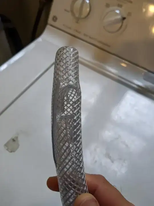

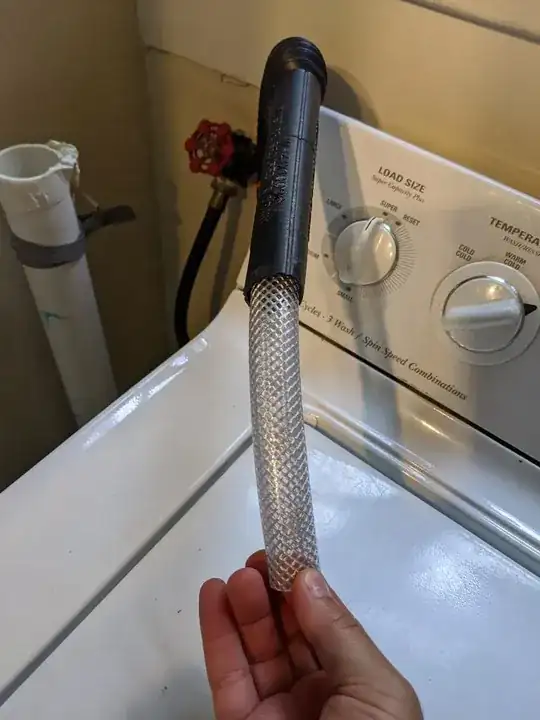

I had the same problem with a new washer overflowing an old drain pipe. Tried snaking it, Drano-ing it, and plundgering it but no luck - it still would not drain fast enough to keep up with the washer. This pipe was very old and runs under the house, so way too much work to try and increase its flow rate any more invasive other way.
So I ended up reducing the flow rate of the drain hose from the washer by inserting a section of vinyl hose into it. Costs about $5 at the hardware store. I iteratively added flow-reducing notches to the hose until the rate was right.
It has been several months and while the washer now takes a little longer to cycle, it has not overflowed again. enter image description here enter image description here
