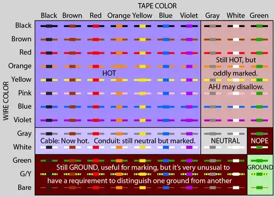

Tape is the key to marking when you don't have 8 colors of wire.
Don't distinguish wires unnecessarily: for instance the two hots going to a 240V heater or 120/240 dryer don't really need to be distinguished from each other.
In your case you need to distinguish two hots from each other, and two neutrals from each other (why? Because you might put a GFCI on one), and potentially a third spare hot.
You can put any tape color on any wire color, but it doesn't always do what you want:
Same-color tape is a little subtle, but is useful for marking. With colored tape it usually doesn't quite match the color or finish of the wire, and you can feel it.
In cable, it's easy to tell which wires are partner to a white, since they emerge from the same cable. This can drive you crazy in conduit with 4 whites coming out of a conduit. In conduit, remarking whites to a hot is disallowed (in most cases) but this cuts both ways: you can use the colored tape to distinguish different wires.
