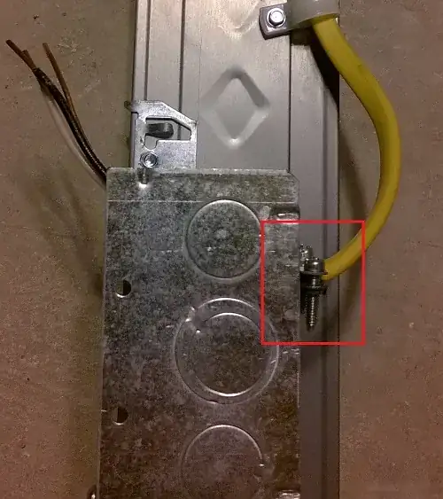

This thing is on my junction box but i don't know what it is or what it's for.Junction box

  • Can you post a photo of the label on the transformer? – ThreePhaseEel Sep 17 '17 at 21:41
  • @ThreePhaseEel i edited my post. This is the only label i can find on it. – hack3rfx Sep 17 '17 at 21:46
  • So, you want to have an outlet wired downstream of this box, on the same circuit as the transformer, right? Can you get us a photo of the inside of the box (with the breaker off, of course)? – ThreePhaseEel Sep 17 '17 at 21:54
  • @ThreePhaseEel see my edit please for photo – hack3rfx Sep 17 '17 at 22:31
  • Out of curiosity, is this wiring in the US? – Toby Sep 18 '17 at 11:15
    @Toby Yes, or at least in these specific photos – hack3rfx Sep 18 '17 at 12:31

19
This is easy
What you have here is a low voltage (NEC Class 2) transformer that steps house voltage down to a safe voltage -- they're typically used to power doorbells or HVAC controls, but may be found in other places as well.
Simply get your new cable into the box with the power off (use one of the built-in NM clamps you can see on the bottom right), then connect black to blacks, white to whites (+a black from the transformer), and bare to bares/greens. While you're at it, use a grounding screw and pigtail to attach the box to the bare/green ground wire bundle.
Then you can install the new receptacle and its box on the other end of the new cable.
