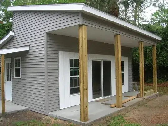

Yes! You can do it.
There is a huge difference between
This
and this
This
The truth is you can very easily build the first example by being your own coordinator. Don't be afraid to hire for complex tasks, take your time. We could go from nothing to a full normal house in about 3 weeks. Of course he had a master plan and called on a lot of people to help, but it was very doable.
You should really hire:
  • Anything that requires a heavy machine like a back hoe. This usually means laying foundations, and running utility lines.
  • Anything electrical
  • Plumbing
  • Anything using glass
The rest is pretty damn easy. You will make mistakes, You will mess up materials. It may even be cheaper to pay a builder to build your house, But at the end of the day, a house is just a bunch of wood pieces nailed together. It's really not a lot more then that. Electrical, plumbing, utilities, etc. they are all important, and need consideration, but if your willing to hire out, then there not relay an issue.
