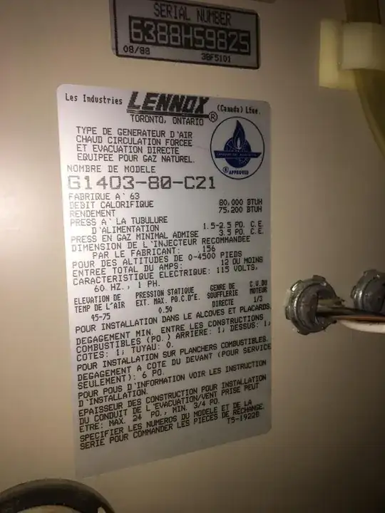

I have a Lennox G14Q3 propane furnace (forced air). I used the Nest/furnace setup last winter without any problems with just the W and R terminals. But, these summer days I would like to push air through the house with the blower (without heat) and remove it with my HRV system.

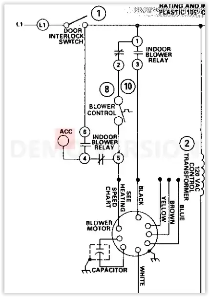

Edit, added model and diagram pictures: enter image description here

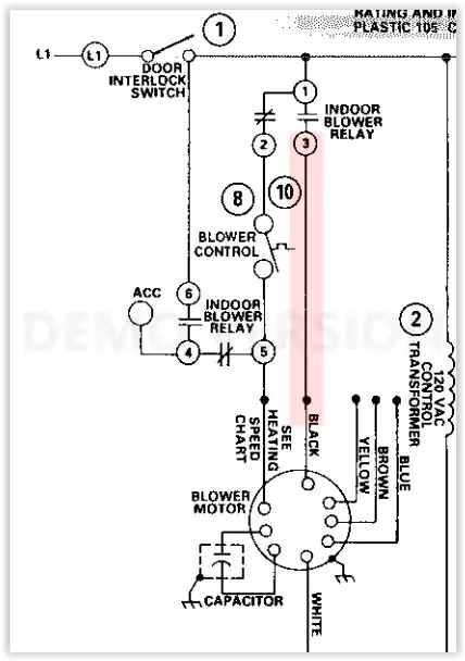

EDIT 2: I realized that ACC isn't actually connected to anything. It gets 120VAC when I switch the relay, but there is still no path to the blower to be energized. Could I just take one of the speed wires from the blower motor and connect it to ACC so that it acts as an indoor blower? enter image description here

  • Do you get 120V from ACC to N when you jumper G to R on the furnace? – ThreePhaseEel Sep 24 '17 at 13:25

  • @JoshJobin -- can you measure the voltage from ACC to N while G and R are shorted together? – ThreePhaseEel Sep 24 '17 at 13:40

  • @ThreePhaseEel where would I measure ACC? Would I need to remove another cover? I know it has power because it sparks and hums a little, but maybe it doesn’t have sufficient power? – Josh Jobin Sep 24 '17 at 13:41
  • ACC should be available from the 120V terminal block on your control board (right next to where the incoming hot and neutral connect to the control board) – ThreePhaseEel Sep 24 '17 at 13:43

  • @ThreePhaseEel the voltage is 120VAC, and the resistance between G and C is 7.4MegaOhm – Josh Jobin Sep 24 '17 at 22:30

  • @ThreePhaseEel I made an edit, could I just connect ACC to one of the other wires used for speed control on the motor? – Josh Jobin Sep 27 '17 at 17:38
Alright, I figured out why it wasn't working. Had nothing to do with ACC not having a lead. I was looking at my setup closely and noticed that only 2 wires were coming up from the motor, but it needs 3. I noticed that there was a wire coming from pin 3, but it was crimped and didn't run to the motor. So I looked at the speed table and decided I wanted to run the Brown wire up. Connected it to pin 3. Now when I short R and G, the fan turns on :) enter image description here
