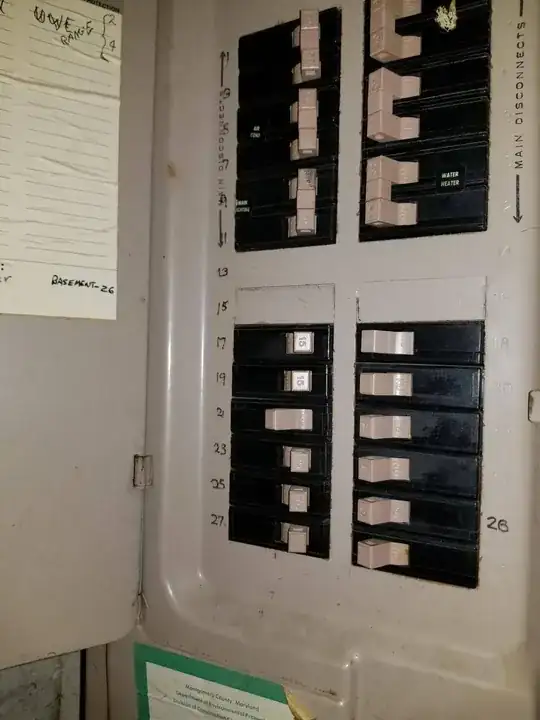

Find below a picture of our USA house's electrical panel (There is a box enclosing the panel that for the time being can only be removed enough to get an angled look/shot of the panel, not straight on, sorry).
Adding up the amperages on all the breakers (even the double pole ones, which I presume are to get 240v at the amperage written on one of the two cream coloured plastic ?paddles?) comes to 450A (700A if both numbers on each double pole breaker are inserted into the calc). Just the single pole breakers adds up to a more expected (to me, given the house was built in the 70's) 200A.
Further complicating the self-determination of total allowable amperage of the feed into this panel is the top two banks of breakers have "Main Disconnects" next to them, but some are instead labeled with high amperage appliances (the rest aren't labeled (?any longer?) as to what they control power to). Lastly, there doesn't appear to be a ?easily accessible? main breaker to definitively determine amperage of our service.
Can anyone help with the question of total amperage able to be drawn through the panel with installed breakers, and/or if needed, debunk some of my assumptions?
Home Electrical Panel

  • janka is apparently assuming the European 240V 3 phase system, while I suspect you have the North American 120/240V single phase system - which is it? – Peter Bennett Oct 05 '17 at 20:53
  • @PeterBennett - Hi! Made sure there wasn't a rating on the panel visible before bothering the community with the question. There is no breaker having anywhere near 100A written on it visible without taking off the panel cover (I was hoping to find that, as that would have answered the question). I am wondering if the picture in this posting is visible on your end? – user66001 Oct 05 '17 at 20:54
  • @PeterBennett - Good point. Had forgotten that there aren't just US users on SE sites. Question updated. Am more or less sure it is single phase (house, not business), but was going to leave that to the (I trust) more experienced people addressing this question to tell me how I can determine that/determine that themselves. – user66001 Oct 05 '17 at 20:56

This is a classic "Rule of Six" panel
Where's the main breaker? Electrical service to houses used to be 60A. As it got bigger, there was a problem - large breakers like 100A or 200A were very expensive. A compromise was struck where the "main breaker" could be up to six smaller breakers. That's what you see in the upper part of this panel.
They are not paralleled! Each of the breakers serves a different load.
This panel, like many "Rule of Six" panels, has its own built-in subpanel - that's what you see in spaces 17-28. The subpanel area is fed by one of the six breakers in the "Rule of Six" area. This feeds all other loads in the house.
(Space 15-16 are not spaces, the lids are renovable but there are no busbars behind them.)
Your loads
What is in the upper area? Probably, based on labeling,
  • space 1,3 50A ??????
  • space 5,7 50A air conditioner (a little large? Maybe a heat pump with aux heat?)
  • space 9,11 50A the subpanel below
  • space 2,4 40A range/oven
  • space 6,8 30A ?? likely an electric dryer
  • space 10,12 30A water heater
You notice this adds up to 250A -- there's no such service size. You also notice the subpanel breakers add up to way, way more than 50A, so you can see it's normal to oversubscribe breakers on a service. Actually, breakers are there to protect wires and appliances. Wire size (e.g. 12 AWG) decides breaker size (e.g. 20A).
What size is my service?
As far as the subpanel area, your service is 50A, but hold that thought.
As far as the capacity of the "Rule of Six" area, you'd need to consult with your power company or look for evidence at your meter or your meter base.
EDIT: You could also pop off the panel cover and inspect (carefully, from a respectful distance) the fat wires landing on the main lugs at the top of your panel. Look for a size number right before the letters "AWG". Expect 2, 1, 0, 00, 000, 0000, 1/0, 2/0, 3/0, 4/0 (these are the same as 0 thru 0000). Or right before the letters "MCM" or "KCMIL" expect 250, 300, 350, 400 or 500. Those wires come from your meter and will inform the size of your service, as these are the wires that will burn your house down if you overload them.
EDIT: Your other limiting factor is the capacity of the panel. Search it for marks as to its maximum capacity in amps, typically 100, 125, 150, 200 or 225. Exceeding this is out of the question.
Keep in mind you only have 5 breakers in the "Rule of Six" area and you are full. You can get CH breakers up to 100A ($50) or 125A ($110) in the normal shape (which would force you to abandon one large appliance)... or 150+ amps in "beast mode" packaging, where the breaker is 4 spaces wide (eliminating two large appliances, ouch).
The problem with the "Rule of Six" design is there is no main breaker to keep you honest, so nothing really keeps you from putting in six large things and overloading the circuit and burning those wires. That's why Rule of Six was outlawed. You can't buy a panel like that today, and you shouldn't continue this one in service any longer than you have to. Dismantle it lovingly, and offer it up on eBay. It'll save someone's bacon. But only sell it to a licensed electrician.
Get a better panel and make this a "Rule of One" panel
If it was my house, I would add an additional sub-panel quite near this one, and move all my loads to it. Then I would fit one of those big CH breakers in the "Rule of Six" area and have it only power that subpanel. Put blanking plates over every other space in the old panel, and you now have reduced it to a giant main breaker only.
EDIT: Alternately 2 or 3 subpanels, as I would not be inclined to pay the big bucks for the 150A jumbo breaker.
I am very picky about panel brands. CH is a fine type (other than this one being "Rule of Six"), and I would even consider CH for my new subpanel. Reuse all your breakers!
It needn't be done in one sitting. Find a period when you can do without enough loads out of the Rule of Six area to make room for the new breaker (like A/C in winter). Once you wire up the new panel, at that point both panels are live, and you can move the other loads at your leisure, one per Saturday or whatever works for you.

This is likely a split-bus panel where you have multiple main disconnects. The "Main Lighting" breaker (50A) is probably what controls the lower set of breakers, and is your effective capacity if you're considering adding new circuits.
See:
Edit: I previously assumed there must be a separate main breaker, but after recognizing this as a Cutler-Hammer panel (my house must have also been rewired in the 70s) and googling a bit, I found the above answer which should also apply here. Thanks to @Speedy Petey for the helpful answer there, and @Peter Bennett for a comment below that set me on the right path. I'm replacing my prior incorrect answer.

  • I wonder if the two-pole breakers in the top section together serve as a main breaker. (The OP did state that he traced wiring back to the meter, but couldn't find a main breaker). The 50 Amp breaker marked "Main Lighting" then may feed the bottom single-pole breakers. I don't think this would be legal here (British Columbia), but electrical codes do vary with time and location - perhaps this arrangement is/was legal in the OP's Maryland at some time. – Peter Bennett Oct 05 '17 at 21:31
  • Thanks for your answer Shimon, I will need to determine my feed capacity to see if there is need for a heavy up (as I understand it is called in the States), and realise this will also answer the question, but before I can get better access to the panel and it's surrounds I had hoped that someone could clarify with me how the amperage ratings of the breakers shown in the picture combine to determine total maximum amperage able to be pulled through the panel as far as those breakers will allow. – user66001 Oct 05 '17 at 21:32
  • I was trying to reason through a response but holy crap you're right, see https://diy.stackexchange.com/questions/72717/where-is-the-main-shutoff-my-cutler-hammer-breaker-box – Shimon Rura Oct 05 '17 at 21:37

I think I see where you are going wrong with this part, other people in comments have pointed out how to try and track down the main breaker. As for the wrong assumption, you will not learn anything by adding up the amperage of the individual breakers in this box. They can add up to way more than the box can handle, and that is just fine.
All breakers are about protecting a specific circuit for overloading. Most of them are about the circuit from the box out into your house. So a given 15 or 20 amp breaker is determined by the wire in the walls. The wire coming into your house also has a max rated amperage as well and that is what is protected by this main breaker that cannot be found. In my house that is a wimpy 100 Amp breaker.
In the panel I have some big branch circuits like an electric double oven, an air conditioner, a sauna, a big table saw. Just those are almost 200 Amps. So I have to be careful about which things I run together. I cannot run the table saw when both ovens are on from experience that plus the random lights and other things push my total draw over 100 Amps. Which triggers the main breaker to protect the panel and incoming wires.
One thing you could do is call your power company and just ask them what sort of service you have, they will be billing you based on that and should be able to also let you know how much it would cost to upgrade your service to something bigger. I found out is costs enough that I just don't work in the shop when there is lots of cooking going on in the house.
