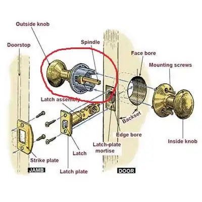

If it is accessible, take the circled part of the door knob and put it into the hole. You'll then be able to open the door.
diagram of a door knob/latch assembly

    [John Rawls](https://diy.stackexchange.com/users/76965/john-rawls) mentioned in his question that he *left both sides inside of the room* he was locked out of. – Mark Booth Oct 26 '17 at 10:13
    @MarkBooth He doesn't say that it's the only door handle he has available. Square spindles are standardised, so any door handle spindle will fit any latch. You could even take one off another door (although of course if you've got a screwdriver set then other answers give you quicker ways of solving the problem). – Graham Oct 26 '17 at 12:20
  • If he had a spare @Graham, do you think he would be asking how to open the door without a spare? As it is, I'm not convinced that this requires a square spindle, since the hole in the sleeve is the wrong shape for it. I have never seen Kwikset latch like this though, so can't be certain, but it looks like it might require a semi-circular latch: https://i.ytimg.com/vi/QXP_9iXv1L0/maxresdefault.jpg – Mark Booth Oct 26 '17 at 13:59
    @MarkBooth I read too fast, sorry. – flaviut Oct 26 '17 at 14:38
