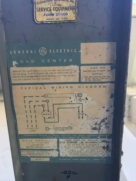

These 3 wires connect this main disconnect to my sub panel in the back of the garage that powers the whole house. It runs in a conduit that serves as the ground between the sub panel and the enclosure in this picture. I am replacing the cable/conduit with a 4 wire SER cable (separate ground). How would the ground in that new cable attach to this enclosure? Neutral and ground can be bonded since this is a main panel but there is no lug available and no space on the tiny bar that’s there. Can I drill and tap a lug to the enclosure? Doesn’t seem right...

  • Can you post a clear photo of the labeling on the disconnect box? – ThreePhaseEel Nov 12 '17 at 06:29

  • I can add a picture of the inside label but I have reviewed and it only covers the connections shown. No mention of a ground wire that I can see. I am replacing conduit that runs below ceiling level as part of a garage finishing project. – gorms Nov 12 '17 at 07:02

  • We'll want to see the label anyhow -- it'll tell us make/model of the box, if nothing else. – ThreePhaseEel Nov 12 '17 at 07:10

  • I have added a picture of the label. The conduit is in a really bad place to accommodate in the garage upgrades. It crosses diagonally across the garage ceiling, several inches below the 8 ft ceiling height, interfering with where lights would go and storage areas above the ceiling joists. There are some 220v circuits that use EMT conduit grounds to the sub panel (which I’ll keep) but there are many other 110v circuits that use bare copper ground Romex wiring. I really want this thing gone! – gorms Nov 12 '17 at 18:58
