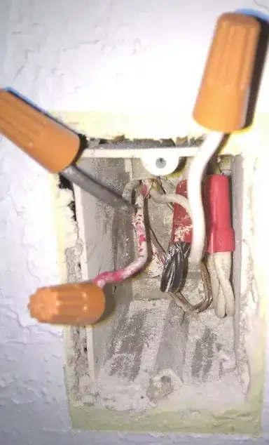

Here is the box where I am trying to put the indicator LED:
Indicator Box

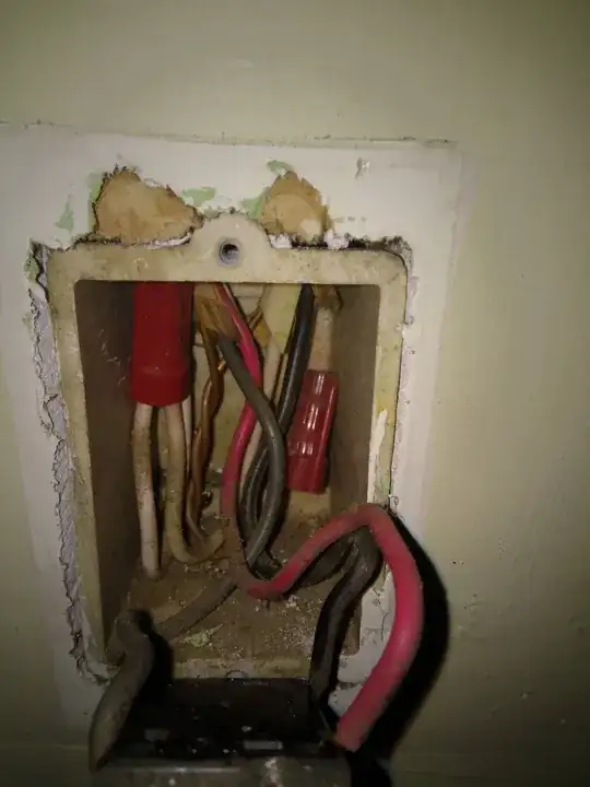

Here is the switch in the garage closest to the interior of the home and subsequently the indictor box above:
Close Switch
Here is the switch on far side of garage and subsequently closer to the breaker box:
Far Switch
So interestingly enough Ken, I had already made a pigtail and tried to use those neutrals tucked back in the indicator box already. But when you suggested this again, I tried again, to no avail, but noticed something interesting. When I hook up the black from the 3-wire and the neutrals from the back of the box and flick the switch on....none of the 3-wire wires are hot. With just the black hooked up to the LED, all 3 wires remain hot when the light is on. But when I connect up that neutral from the back of the box to the LED, with the black from the 3-wire the all of a sudden go limp.
And FWIW, the set of black wires in that same box that are wirenutted are always hot no matter what.

As I am looking at the three pictures I find the one that is bothering me the most is the indicator connection. I see a R,B,W,C wire set (which means it has to come from either outside of this circuit (switch 1 and switch 2) or it is 'spliced' / wire nutted in somewhere along the path of the traveler wire set (R,B,W,C) from switch 1 and switch 2. and you said when switches on that white was hot too (wrong thing by code).
Indicator Box
TO MAKE IT WORK
So if all are hot when switches are on - to make it work you can pick that wire nutted white wire (with the pretty red wire nut) back of box on the right hand side where the 2 two line sets are nutted together (verify that it is a neutral measure between it and the Red or Black of the (R,B,W,C) wire set; If you read 120V use that for one lead to your LED and then use the Black from the (R,B,W,C) wire set for the other - it should work.
That said I would not say the wiring is correct as the (R,B,W,C) set in the indicator box - where does it come from and how is it connected ?

  • @ken hopefully this helps. This is a picture from the box i'm installing the indicator in - https://ibb.co/mNusq6 This is a picture from one of the switches in the garage, the one closest to the box above (then one I want to install the indicator in) - https://ibb.co/fobSOR As you can see, the 3-wire romex running from the switch over to the indicator outlet indoors has an almost greyish (hot) so hopefully that helps make things more clear. – jaxwithanx Nov 17 '17 at 00:03
  • @ken and here is the second switch on the other side of the garage controlling the garage light - https://ibb.co/mZXJf6 – jaxwithanx Nov 17 '17 at 00:40

  • @jaxwithanx - I posted some steps on how to check it - and also picture of what I see you have Switches first 3 way circuit. You posted pic of switch 1 - no problem - just look at the troubleshooting steps.. – Ken Nov 18 '17 at 21:39
  • @jaxwithanx - the issue I am seeing is the indicator wires Red,Black,White, copper - this appears to be spliced in somewhere - it does not seem to be a direct run.Your switches show what looks to be correct 3 way wiring.- if the R,B,W,C travels to the other. Your indicator though has 2 blacks and 2 whites tied together - I can't imagine why that would be in your indicator box unless that is the run to your garage light ; in which case I would attach my LED to that and leave the 3 wire set wire nutted. – Ken Nov 20 '17 at 06:52
  • @jaxwithanx Posted the answer to your issue at least to make it work - considering your wiring in that indicator box looks screwy - not sure what that all is exactly in relation to how a 3 way light switch circuit should be wired and what they wired to get the indicator. If it were me I would have mapped it out with a meter to find out how it is wired what went where (probably a trip into the attic as well ) - sorry took so long. The proper way to have hooked in an indicator like that would have been to simply to come off of the wires that go to the garage light - simple 2 wires. – Ken Nov 20 '17 at 07:23
  • @ken updated the post with the pictures and what happened when I attempted your fix – jaxwithanx Nov 27 '17 at 02:47

Connect the 'hot' side of the LED to the common of the switch. This terminal also supplies the switch leg of the light in the garage. Connect the other side of the LED to a full time neutral. This should take care of it. P.

  • Thanks. So that should more than likely be my red and white. The original owner did a good job with keeping these things color coded, even when adding little details like this. First I need to reinspect that LED housing for some markings. – jaxwithanx Nov 14 '17 at 07:07

Process of elimination. The two 3-ways in the garage only have 2 cables coming into them - one /3 and one /2. The /3 must necessarily include the 2 travelers (red and black here). This is a bone-stock 3-way setup, and can only possibly be that. This accounts for all the wires in those two boxes.
Now we have a third box. It has two /2 cables that are thru-nutted to each other and pushed into the back of the box. Those probably don't have anyhing to do with the garage light but is just power passing through, possibly with an eye toward future expansion. Then you have another (!) /3 cable, and since only it was disturbed, the garage indicator light must be powered by it. That's weird. /3 is expensive cable and not used lightly. Perhaps it was part of a former 3-way circuit which was since re-tasked for this purpose.
We know the indicator is not in series with the garage light because the garage light works with these wires loose. We also onow a non-series indicator lamp needs 2 wires: neutral (to return current to source) and switched-hot (to power the indicator only when the garage light is on). And it worked before, so those wires must be there. The question is, which 2 of the 3? (And idly, what does the third do?)
