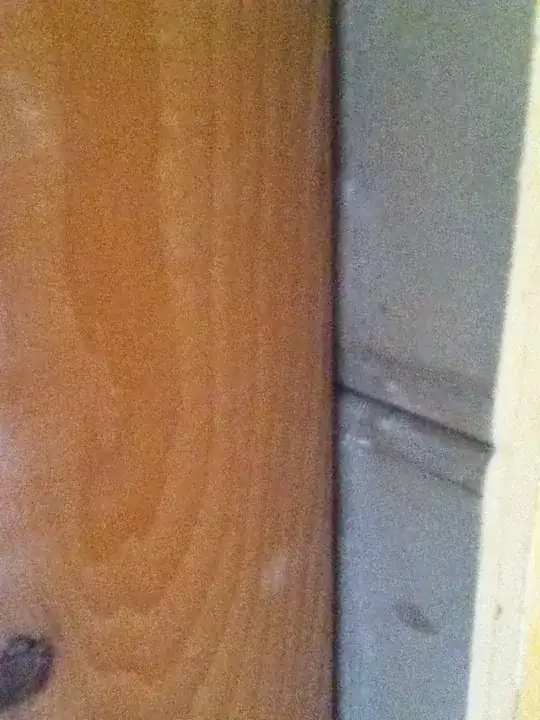

Pics of my windows:
BATHROOM - one little window, sliding:
KITCHEN - two windows, sliding:
BEDROOM - one window, sliding:
And then I have a sliding door in my living room.

  • I had a house years ago with crank-out windows. We were able to find a vertical style air conditioner that fit one of the windows. A vertical style AC unit will be more expensive but they are made to fit your sliding style windows and some crank-out windows. – ArchonOSX Nov 22 '17 at 10:01
  • This [answer](https://diy.stackexchange.com/a/6433/33) might be helpful. – Tester101 Mar 05 '18 at 15:58
  • Why do you think the sliders can't be used? The area above the AC unit can be sealed with a piece of rigid insulation board cut to size . – Ed Beal Jul 14 '18 at 10:05
As mentioned in another answer, casement window air conditioners are available.
The portable units work okay. Obviously they eat some floor space. You may have to empty the condensate that collects. You have to run a dryer type hose to exhaust hot air. The units usually come with a mounting bracket that go in a window, but somehow these are always useless plastic junk. However it's very easy to make a plywood window bracket for the hose. It's not that hard to install a permanent dryer vent if you'll use the same unit in the same window every year.
You can buy air conditioners that are made to install in a permanent wall penetration, search for "through-wall air conditioner" - they usually have a sheet metal box that stays in place year round. There is obviously some carpentry involved but it's not too difficult. If you can place them below a window, usually you don't have to install a header over the opening. If you don't want to DIY it, it's not something for a handyman, but an easy job for a carpenter.

You can buy a casement window unit that fits both sliding windows and casement windows. Just enter the term "casement window air conditioners". Also inquire about an installation kit that will fill in the space above the unit to keep out the outside air.
