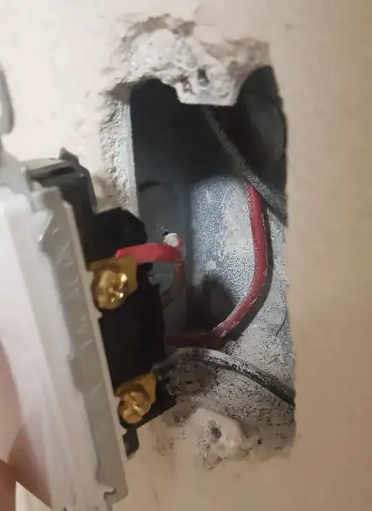

I'm installing a smart light switch into a box with no ground wire, screw, or threaded hole for a screw. The switch box itself it metal and grounded (live wire to box was 120V on my multimeter).
What's the proper way to attach the ground wire from the switch to the box when the box doesn't have a wire or screw?
Edit: Switch is a Wemo Dimmer. Added picture of box (with old switch):
Switch box

  • The wording of your question seems to be off - you declare you do not have a ground wire or a ground screw/ threaded hole and you state the box is metal and grounded. So lets ask you this - is there metal conduit to that box ? Is it mounted to a metal 2x4. Make a screw hole and attach wire - if the box is truly grounded. (measuring box to line - the box could be connected to a neutral and your reading would be the same.) How do you know the box is grounded and not neutral ? – Ken Dec 02 '17 at 09:16
  • A picture of the switch and the ground wire specifically would be required or a switch manufacturer and model – Kris Dec 02 '17 at 16:52
  • @Ken You are right, I havn't confirmed that it is not connected to neutral. I read that sometimes the ground wire is wrapped around the box and then plastered in (I have plaster walls) and that I could use a multimeter to test that. Is there any way I can be confident without opening the wall? – ChrisV Dec 02 '17 at 20:00
  • With a metal box it is required to be grounded through the conduit or a grounding wire wire connected to the box (required for many code cycles) with metal boxes the switch is not required to have a ground other than the box. – Ed Beal Dec 03 '17 at 00:13
  • @ChrisV looking at your picture - when you look at the place where the wires come in - is there a metal conduit that the wires follow through? That is what I would try to get a very good look at to verify. I suspect that you have conduit and therefore the box is grounded. If that is the case - drill and tap the screw hole and attach your ground wire. – Ken Dec 04 '17 at 07:13
