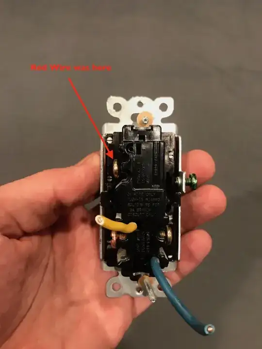

The red wire is a loop and stripped in the middle. It was connected to a screw on the old toggle switch. The blue and yellow wires were plugged into the back of the toggle switch. (see picture 1)
Picture 1 (old toggle switch)

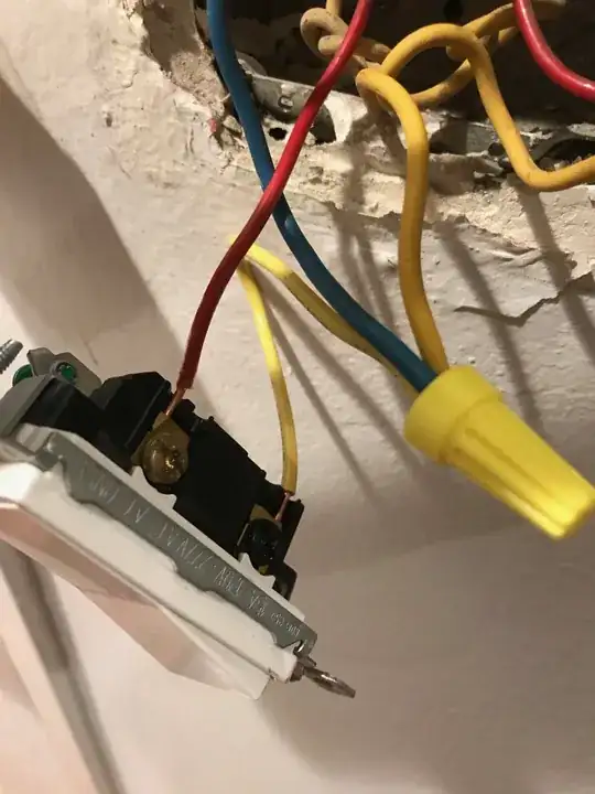

Picture 2 shows the wires in the wall.
Picture 2 (wires in wall)

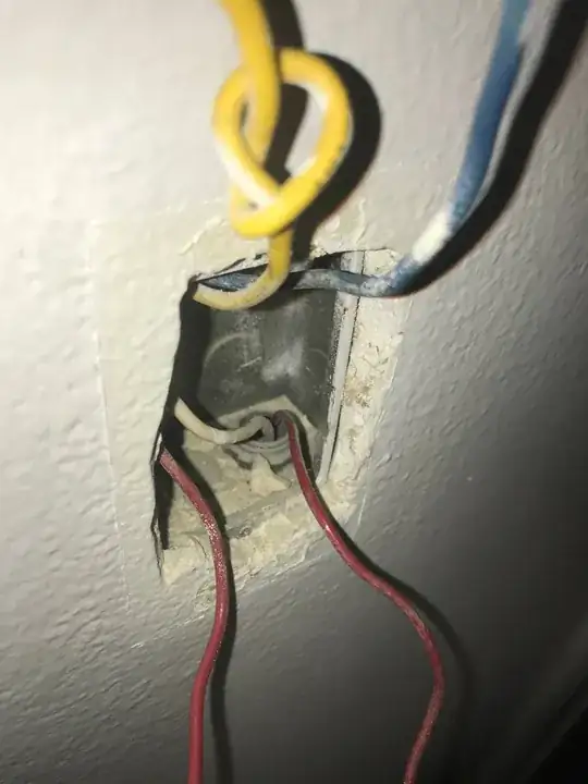

The new smart toggle switch has 5 wires (see picture 3 and 4)
Smart toggle switch front Smart toggle switch back

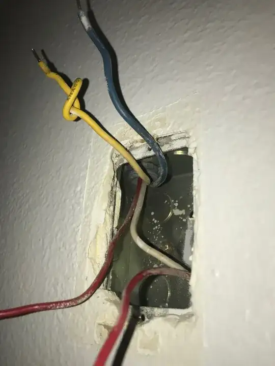

Below are pictures of the wires entering and exiting the box. This includes a white wire that runs from the top left to the bottom right of the box.

  • Can you post a photo that clearly shows where the wires enter the box at? – ThreePhaseEel Dec 27 '18 at 01:18
  • Updated with additional pictures – agf1997 Dec 27 '18 at 01:24
