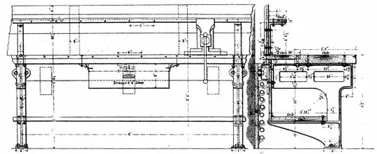

There are two different types of work benches: sitting and standing.
A sitting work bench for machine work, according to Browne & Sharpe, should be 31" high. Note that height of the chair is important and should be adjusted so the worker's knees are at a right angle when the soles of the feet are flat on the floor. Below is a design Brown & Sharpe made for work bench in a railroad shop (31" to table surface):
For a standing bench, the usual height is 40" which is the same as a standard kitchen countertop. This corresponds to the height of the waist of a person about 5' 9" tall. For a taller or shorter worker, the table should be adjusted by half. For example, a person 6'3" would add 2" to the height and use a 42" work bench.
