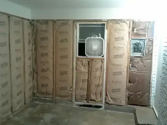

I have 9' walls and the bottom foot or so is cement on one wall. What's the best method to drywall over this wall so no moisture seeps in?
far wall with window
As you can see, there was moisture seeping in down at the bottom below the window. I planned on using a moisture barrier on it, but I'm not sure if this is the best idea out there.

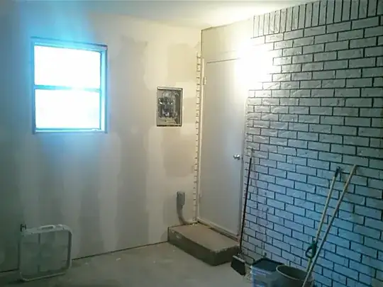

The wall was very unlevel, so I went to Lowe's in search of Lath (my brilliant wife's idea)! I used it to level out the wall and pretty much re-build the wall without having to actually tear it apart. Here's a shot of the lath-ed wall:
Wall with lath I also put some plastic on the bottom to cover the cement area, just in case
And a two shots of the same wall now mudded & tapped: Mud & tap 1 Mud & tap 2
