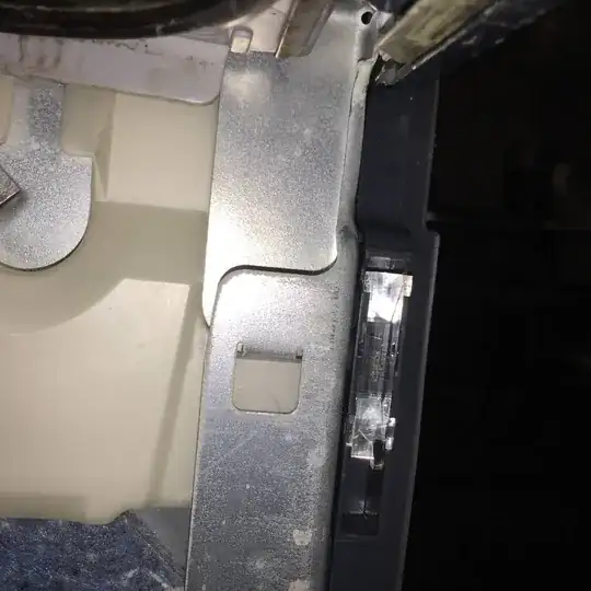

I have been dealing with a minor pest (psocids, in case you're wondering, but I don't want the conversation to become about that), mainly in a kitchen cupboard and the surrounding area. I've already taken a few appropriate steps, and the next step is to try to close various gaps that the bugs use to go through, such as the ones in the picture below at the back of the cupboard (I think they've nested somewhere behind there). I will be doing that with silicone sealant.
Gaps at back of cupboard.
