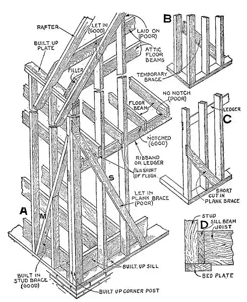

I will add this picture to demonstrate. Your baseboards are against the wall and lengthwise - they do not sink, your floor boards are sinking. So in your situation what can cause the floor boards to sink (rise and fall)..take a look at example 'A' & 'D'. I provided this as an answer because you want to seal it up .. well there are two options: To fix the cause of this gap or to patch around it and hope the cause does not become worse.

  • The house is balloon framed studs over a parged fieldstone foundation. It is old and has had some settling over 125 years, but is currently structurally sound. This gap has probably existed for decades and may date to whenever this current top layer of flooring was installed (maybe it replaced something that was tighter under the baseboard). – Shimon Rura Jan 24 '18 at 17:45
  • That's not the cause of this gap. This gap is an artifact of the way the floor was installed or modified. This is an exterior wall on the 2nd floor, so the floor joints are nailed into studs and held up by a ledger. The joists here run perpendicular to the baseboard. For this part of the floor to sag there would have to be widespread failure of the attachment between the joists, studs, and rib band. That would be a huge obvious problem and doesn't apply. – Shimon Rura Jan 24 '18 at 19:27
