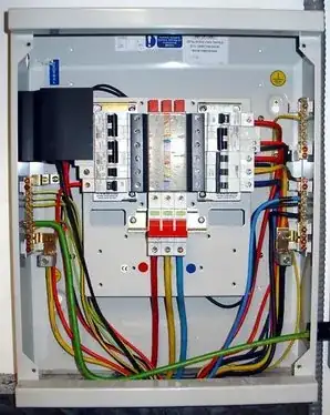

A DB box should be neatly wired, like this.

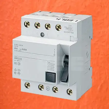

Earth leakage, a life saver! It is easy to install however it can be costly, but its worth it!

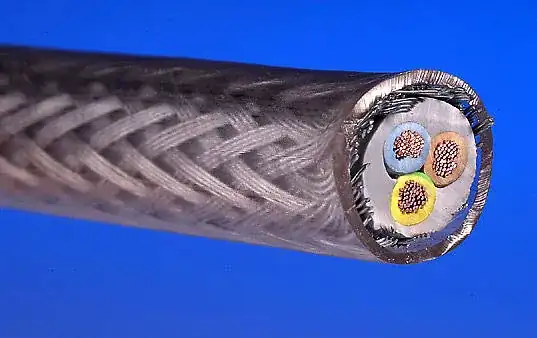

Cables, a shielded copper core flex cable, for extra safety!
