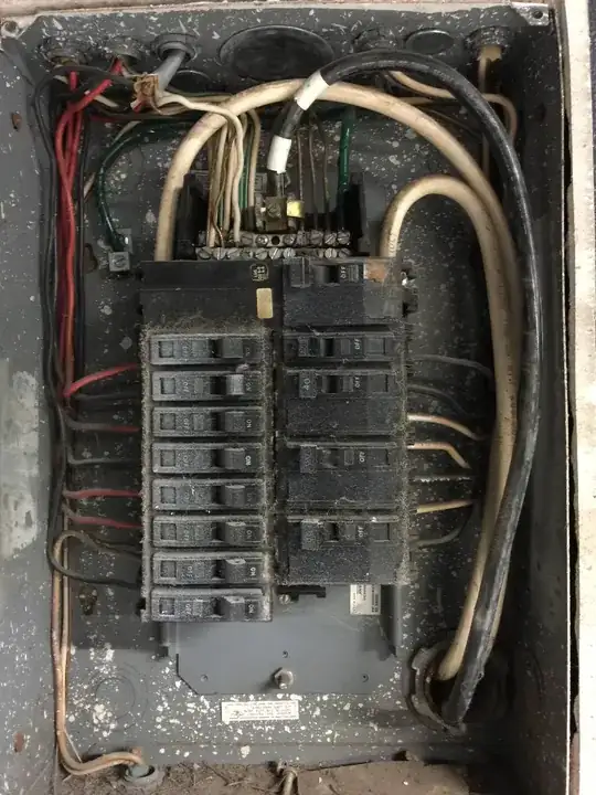

    What a ripoff, for 200$ you could purchase a roll of romex a breaker, an outlet and box to install the outlet. I would not use something like that product even if approved or listed, how many breaker trips are going to happen now that you are loading 2 separate 120v circuits that have other things on them,,, I would just do it right by adding a proper 240v circuit. – Ed Beal Mar 05 '18 at 03:48

  • @EdBeal That's just what those suicide cords cost if you put enough interlocking and safety protection in them to satisfy UL -- mind you the listing is only valid **if you follow the instructions/labeling to the letter**, and those instructions are probably too restrictive for you to use the device successfully. I for one would want to hear directly **from UL** that the listing is bona-fide, any crook can *claim* to be UL listed. – Harper - Reinstate Monica Mar 05 '18 at 16:16
    +1 as the panel photo helps, and for initially going for a *legal* and safer version of the suicide cord. – Harper - Reinstate Monica Mar 05 '18 at 16:31

  • @Ken Yeah, my panel is full. Is it ok if I add to a breaker that already has connection, add multiple connection to a breaker? or I should take the extra step and upgrade the panel? – Ganbayar Gansukh Mar 05 '18 at 14:38

  • @Nomadme his charge was $900 probably because he was going to change your box out - guessing. Also it looks like you have a double tapped breaker (2 conductors on one screw) 6th or 7th down on left side this is a code violation and a safety issue! However If your box supports Tandem Breakers you could replace two of your singles and have space for the new 220V breaker and replace the double tapped with a tandem solving all problems. Of course the total load on the breaker panel must not be exceeded. Given you were looking at a 20 Amp cheater device you are probably ok with 20AMP 220V CB. – Ken Mar 06 '18 at 21:43
  • @Ken Thanks. I decided to add sub-panel to the box, moved out the line that was on 40A breaker, moving it to the new sub-panel. I saw that double conductor on 20A, but didn't know it was violating the code. I guess the previous owner of the house hired someone to do that. Can I extend that with an 12AWG wire with wire nut and add a new breaker? – Ganbayar Gansukh Mar 06 '18 at 22:14

Even for less than the $200, you could install a subpanel in the garage, and take some of the pressure off that overstuffed (but excellent QO) main panel. I gather the 40A is your range. Do any of those 30A circuits already go to the garage? Dryer, water heater, that kind of thing?
  • Yes, sir, those goes to the house and already being occupied. So I just find out that I can use tandem (double) breaker to extend the usability of the panel. Do you think it is a good idea or I should just replace the panel to a bigger new panel. Seems like the one I have currently is Square D Load Center, Cat # QOC-20M, series E6 panel. – Ganbayar Gansukh Mar 05 '18 at 19:37

Your power panel is full, so change out two of your single breakers for Tandem Breakers and this will free up space in the panel so you can add a 220V breaker.
Repair what looks to be a double tapped situation (2 conductors on one screw) on breaker [6th or 7th down on left hand side] by replacing it with a tandem breaker as well. Double Tapped breakers are a fire hazard which is why it is also a code violation. The other way to fix that is by pig tailing the two wires with a third wire which would then feed the single connection of the breaker. IMO you are in the box already changing breakers so just change it to a tandem breaker and be done with it.
Since the device you want to use is a 20 AMP device, Add the 220V 20 AMP Breaker in the newly created space in your panel.
Make sure your panels rated capacity can support the added circuit breaker amperage. This stack link should be helpful I also include the literal link just in case the link goes bad and someone else needs to do a search https://diy.stackexchange.com/questions/31604/do-the-breaker-amp-readings-sum-up-to-dictate-my-current-panels-total-possible
Now you have resolved all of your issues with a simple solution - total costs for these 4 breakers is about $50.00 at a big box. Your 220V Receptacle $10 and wiring [4 wire L1, L2, N, G] cost is dependent on how much length and gauge [#10/3 with ground] @ $1.27 / Foot ... that should put you in at just under $100 total.

  • I decided to add sub-panel to the box, moved out the line that was on 40A breaker, moving it to the new sub-panel. I saw that double conductor on 20A, but didn't know it was violating the code. I guess the previous owner of the house hired someone to do that. Can I extend that with an 12AWG wire with wire nut and add a new breaker? – Ganbayar Gansukh Mar 06 '18 at 22:20
  • And I'm not sure if my main panel support tandem breakers, it is old. The model Square D QOC-20M Series E6. Not sure if it supports, I couldn't find any info on it. Tandem breakers for QO style (I guess old school style) I found was $47 for 20A. – Ganbayar Gansukh Mar 06 '18 at 22:23
