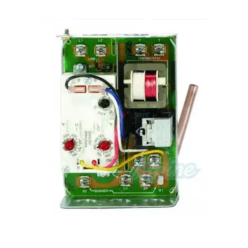

The system uses a Honeywell "aquastat" controller that has an integrated transformer hooked up to Rh and W, so there's no way to add a common C to that transformer (short of what this guy did with taking apart the control unit and soldering a wire to the back of the board).
Here's what it looks like (though this is a much newer model, it looks pretty much the same): control unit
