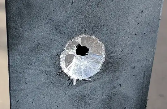

I'm trying to drill a 0.75" hole in a metal pole. I got a 0.75" drill bit from Home Depot (DEWALT 3/4 in. Black Oxide Reduced Shank Drill Bit) that I was told is appropriate for metal. I used a punch to create a pilot dent. I then tried to use the 0.75" bit but it kept on slipping. I did some research and it said that you could drill a pilot hole but that it shouldn't be more than 25% of the target size. As such I drilled a pilot hole and that seemed to help and I then made some progress with the 0.75" bit.
I've now got to the point where there's a lot of vibration in the bit and the hole that it's creating is larger than 0.75" on the outside. The extra size is not a problem - just stating a fact.
The problem is that after progressing through the metal I seem to be "stuck" at this point inasmuch as it's extremely difficult to get it to go further.
My question: Do I just continue to apply force and push on the drill to keep going or is there a technique that will make this easier.
(I'm wearing safety goggles, gloves etc.)

    Did you use any sort of lubricant, such as (clean) motor oil? 0.75" is rather large to be drilling by hand - is the drill rated for it? Are you rated for it if the drill bit snatches? How do you feel about filing the hole instead of drilling it? – Andrew Morton Mar 16 '18 at 17:02
    usually, you should start with a small size drill bit and work your way up to the final size. .... try a smaller drill bit, maybe 3/8", then 1/2" .... if the hole is off the mark, then use a file to re-center the hole before you get to the final size drill bit – jsotola Mar 16 '18 at 17:07
  • Is the bit grabbing and causing the drill to stop? if so use less pressure and a higher drill speed. Is the bit just spinning and not taking off any metal? If so slow the drill speed and use more pressure. That looks like aluminum which should drill really easily, however the bit has a tendency to grab when you're close to going through. – Platinum Goose Mar 16 '18 at 17:12
    its getting harder because you are work hardening the metal. You might want to try drilling from the other side since you have a pilot hole. In any case you should be putting a lot of force on it (as in almost all of your weight). If you feel in danger of stalling or breaking the drill get a bigger drill ( you can probably rent a big heavy duty drill or even a portable drill press. ) – agentp Mar 16 '18 at 20:05

To answer your question, based on where you're at, meaning that hole we see in the picture with a drill bit vibrating as you said (which is beyond the point of starting the whole with smaller bits), in my experience (I have since learned my lesson), you should use a drill with high speed, and not make full contact with the metal, kinda keep a certain distance so you only hit the raised spots where your'e making the hole to eventually smooth that surface out and avoid the vibrations. Beware though, because this is a large bit, if you are in high speed (low speed as well), if you don't protect your arm, meaning grab on to something, what can happen is, the bit can get stuck and spin on you and you can even break an arm, so BE CAREFUL. You can also use a step drill bit. Again, this is based on where you're at.
