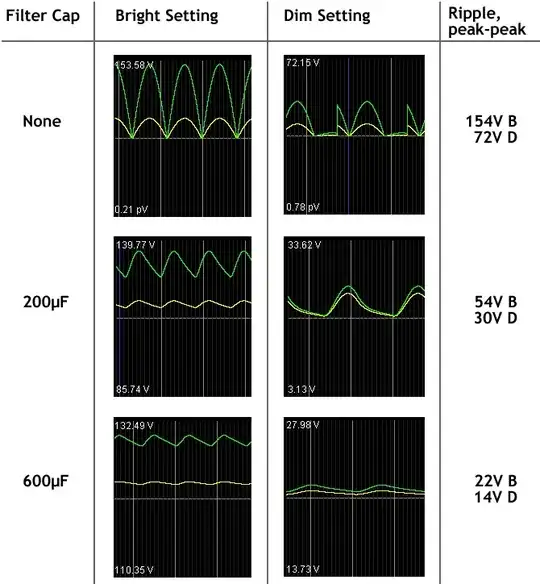

Here's the effects on the voltage, to the lamp, for three capacitor values. Note that the inductor is still required to deal with all the spikes, and harmonics, a dimmer induces...
Filter effects
Reference this simulation (crude but free!).
We can see that by 600µF, the power is smooth enough that buzzing should be eliminated.
Here's an 820µF cap that should work nicely, cost about $4. (Just in case, monitor its temperature carefully for the first few hours of operation.)
