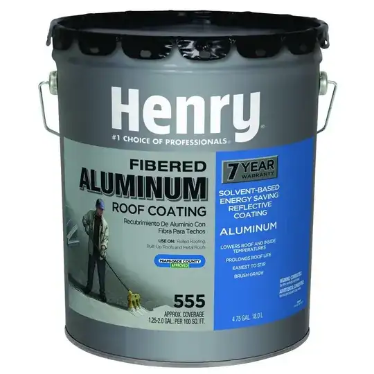

My house has a tin roof over a porch. The house is about one hundred years old, and the tin porch roof is original, as far as I know.
My question is whether the tin roof (which is currently in good shape -- no rusting or leaks) will last indefinitely provided that I periodically apply layers of roofing tar to maintain it, or if tin roofs only last so long.
Another way of asking this is: "Is roofing tar a temporary fix for tin roofs that need to be replaced, or will it keep the roof in serviceable shape indefinitely when applied properly?"
When I say "roofing tar," I mean a coating like this, not the "wet patch" temporary fix stuff:
Enter image description here
I ask because a contractor is trying to convince me to hire him to replace the tin roof, but it's currently fine and has apparently been there for a long time, so it's not clear why I'd need to rip it out and install a new one.

  • that coating looks more like a paint than a tar. I used to use a two-part aluminium bearing paint on tin rooves where a metal-look was desired, and a acrylic latex where a non-metallic look was desired. both were guaranteed for 15 years. (2 coats) – Jasen Mar 29 '18 at 22:46
