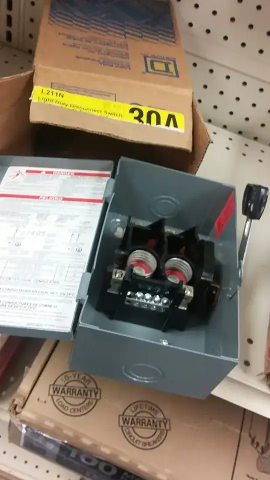

As it happened my local building supply had an already open shutoff switch/fuse combo. Here is a pic. Note screw fuses.

  • At the risk of being another question, what do the fuses and fuse box even look like for an application like this? The only fuses I've seen are the Edison base fuses used in homes 60 years ago. – JPhi1618 Apr 04 '18 at 14:34
  • @JPhi1618 The fuses look like a little tube of chapstick. They’re a couple bucks. The disconnect is in a little enclosure, like 7x5” should be in the same aisle as fuses and breakers. Google fuses disconnect it’ll show many pictures. Or can be seen near almost any home heat pump or AC unit. – freshop Apr 04 '18 at 15:32
