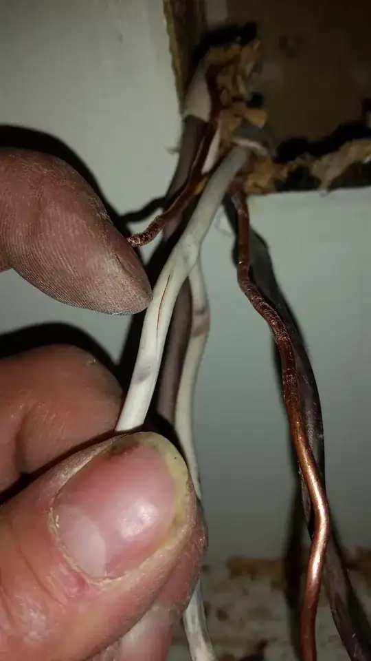

enter image description here I've run across this a few times in the house where I've been doing repairs. Normally, I would just tape it up and call it good. I mean, the tape itself is rated at 600 volts. Someone told me recently tape is not listed for repair, only marking. I am a bit confused about UL listings. Where do you find them? And how do you know what something is listed for? And finally, what is the proper way to repair cracks or cuts in wiring insulation?

  • By the way, the wiring coming out of the hole in the wall was removed from its box, which I took out of the wall. I'm replacing it with a bigger box in order to fit a GFCI along with the four cables. You can see from the pictures if you look carefully at the wiring they were being pinched in places. – Nicknamednick Apr 08 '18 at 03:24
  • It is possible that the insulation separation that you are showing in that white wire is due to (a) it having older relatively soft PVC insulation and (b) the wire was squeezed very tight in a clamp against other wires so that (c) the copper conductor pinched the insulation and made it separate. To be honest it does not really look like a cut. – Michael Karas Apr 08 '18 at 04:56
  • Michael Karas, believe me, it is a cut. You can see the score that continues downward at the bottom of the slice. The diy'er before me was quite handy with his razor knife and did not bother with repairs of suchlike in other boxes. At any rate, the question is, Repairs: The proper material or method for nicked wiring. – Nicknamednick Apr 08 '18 at 13:14

    @Nicknamednick - On closer look I guess I agree with you. Must have happened when using a sharp utility knife to slit the insulation jacket on the cable. On the other hand I have seen an over aggressive tightening of a metal cable clamp squeeze right through the insulation or the cable entering a 50A RV outlet box. – Michael Karas Apr 08 '18 at 17:04

Electrical tape can insulate a splice all on its own, so this should be fine
UL-listed thermoplastic electrical tapes are intended to be the sole insulating means on a splice or joint (the White Book says as much), and are tested for their capacity as an insulating material, so using them to repair damaged wire insulation within a junction box should be fine in practice, even though neither the NEC nor the UL White Book speak directly to this use of the product.

PVC and rubber Electrical tape has been used for decades to insulate electrical joints. It is sufficient for the job. Nothing else is required.
Here is the 2015 UL White Book listing for insulating tape.(somewhat formatted)
INSULATING TAPE (OANZ) USE
This category covers rubber insulating tape for insulating joints and splices in electrical conductors where an outer covering of protective mate-rial, such as friction tape, is intended to be applied over the insulating tape. This category also covers thermoplastic tape intended for use as the sole insulation and covering of joints and splices in electrical conductors. This tape is suitable as electrical insulation at not more than 600 V and at temperatures not exceeding 80°C (176°F).

Read NEC 110.3.
When a manufacturer sends equipment to UL for testing, they include its labeling and instructions. UL tests the equipment consistent with those instructions.
As a result the equipment is now listed for use according to instructions.
Use contrary to instructions violates 110.3 because the item has not been tested for that use.
