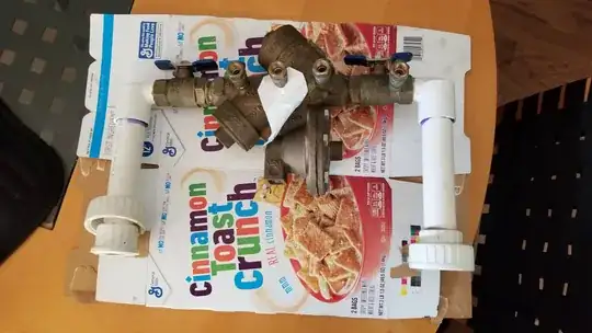

I am going to reattach my backflow preventer today (save 125 vs calling company). Do I need to apply any plumber grease or pipe glue to the pvc portion? Here are some pics of the preventer and place to attach it.

Your o-rings, which pop out easily, are still present. (Black rings on the fittings in the grass.) I would pop those off and clean them and apply a [silicone lube](https://www.amazon.com/dp/B0039ZE2HK/ref=cm_sw_r_cp_api_K5IYAbPQN47Y3) made for o-rings. Does your state require annual re-certification of Backflow preventers by a certified Backflow inspector? Most states do. – Tyson Apr 08 '18 at 15:04

1@JimStewart I don’t know the exact procedure because mines underground and 2 people can’t really look down into the pit at once, but there are 4 test ports (blow up op’s second pic and you can see them) a pressure gauge is attached to one port, and then a hose connected between two others, somehow black-flow is simulated using mainline pressure. Although I blow my irrigation system out myself and start it back up I still end up paying a service call every year for the backflow test, the results/form must be sent to the water dept, or they shut you off. – Tyson Apr 08 '18 at 20:00
