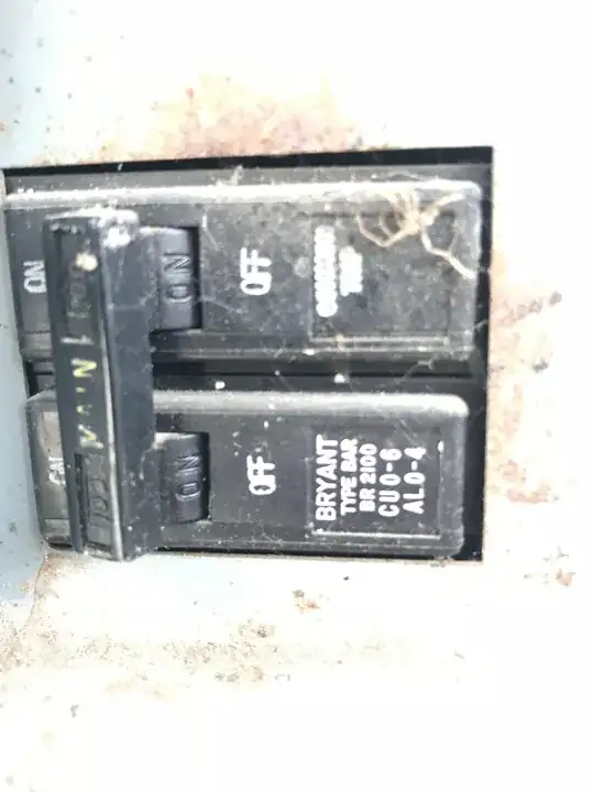

I’m having a pool put in and the pool guys said they need a 20 amp breaker for the pool equipment. My outside panel says 100 amps (see picture). But my panel inside adds up well over 100 amps. Is this normal? The breakers never trip even with the dryer, AC, and other appliances running.

The inside main breaker is simply a shutoff switch, so its ampacity simply needs to be sufficient (not less than the current flowing through it) not correct (to protect anything) -- the real main breaker is the one located outside. As to that weird looking breaker, it's what's called a quadruplex breaker that packs two 240 volt circuits into one pair of breaker spaces.

  • Thank you for the detailed answer. I added a picture of my indoor panel. Do you know why they would put 125 amp breaker for the main when the outdoor box was 100 amps? Also, I haven’t seen a breaker before that has 4 switches attached, like the AC. It shows 50 amps surrounded by 20 amps. And the switches below it are similar but are all attached with a plate to move them all at the same time. Thanks for all your help. – Bob Fernandes Apr 20 '18 at 14:16
