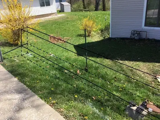

My house is well below street level. The slope from the sidewalk down towards the house is visibly eroding, to the point where I can see the entire side of many of the sidewalk slabs. The yard looks like this:
Slope of front yard

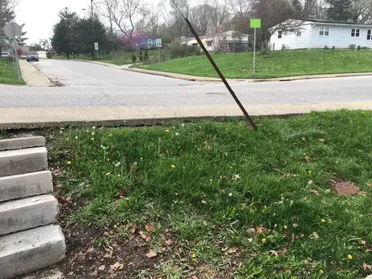

From the house, facing the sidewalk:
View from house, facing the sidewalk
I'm looking to add a wall to my front yard that will serve two purposes:
  1. Retain the slope from the street. I plan to build a retaining wall a few feet back from the sidewalk (roughly where the stone block in the lower right of the picture is located) and then backfill it to bring the grade in front of the wall up to street level (approximately 2.5-3 feet in height). This will prevent further erosion and provide a nice place to do some light plantings along the sidewalk.
  2. Provide privacy and dampen noise from the road. Our code allows for walls up to 4 feet high in the front yard. I believe this is measured from the street level. So, the idea would be to build an additional 3-4 foot wall on top of the retaining wall and compacted backfill.
The finished product would end up looking something like this:
Finished wall
I'm planning to use dry stacking for both the retaining wall and the above-grade extension. We live in a temperate area (6a), so the ground and wall will be subject to frequent freeze-thaw cycles. My thought is that a dry-stack wall will be more flexible and less likely to crack than a wet-masonry wall. It will also be easier to remove portions in the event that the city needs to access the water supply line to the house.
Of course as discussed in other questions, we'll use appropriate techniques for a dry-stack retaining wall such as sloping it backwards, adding a gravel footer and backing, using geogrid to provide structure to the backfill, and installing adequate drainage.
The question is, is it reasonable to expect a 2.5-3 foot dry stack retaining wall to support the weight of an additional 3-4 foot free-standing wall without the whole thing toppling over? Can we expect the backfill to support part of the weight of the free-standing portion?
