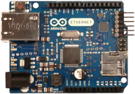

Before the Raspberry the popular choice would most likely be Arduino Ethernet board on it. The costs are slightly higher for this though, There is a Library for use with network available making http communication pretty simple. The drawbacks as of today are obvious, much slower processor, no OS like Linux on it, no SSH, no wireless..(available with other shield + wifi module) and the costs start to pile up.
