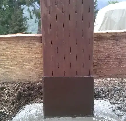

An Oregon project. I soaked my 6"X6"X18' deck roof support posts with two coats of Flood preservative stain. The posts had been kiln dried then sun baked before treatment. The stain dried in the hot sun for a few days. The surfaces were then flooded with Helmsman Spar Urethane - 3 coats. The urethane extends up a foot above concrete to shed water. The concrete is mounded, finished and painted. The post sits on 3/4 minus at the bottom of the hole. I've used this UV protecting urethane coating to protect solar panels on a mountain top repeater installation. After ten years of extreme weather exposure the urethane coating was intact. It is tough material. There is no doubt that the contact surfaces on my posts are impermeable.
