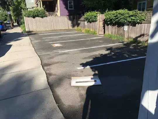

Our home owners association's community parking lot lines are wearing off, about 5 lines, and I'm interested in respraying it instead of calling a professional.
I bought a Rust-Oleum Professional White Paint Spray, and I'm not sure how to avoid over spraying, all I can think of to get the job done is to use General Purpose Masking Tape (ones they use for painting) but that'd likely require at least 3 lines of tapes for each side of the parking line.
Update
Ended up going with the top solution here, and managed to create a stencil after buying grill (its box size was perfect), worked great, and it was a real fast job with this approach.

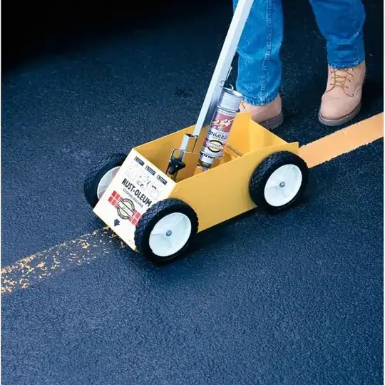

It sounds like you need a Line Striping Machine. If you search your favorite search engine, you can find one of these fairly easily. While there are higher end models with special paint reservoirs and compressors and all that jazz, there are also simpler ones that simply mount a can of spray paint like you have and hold it a constant distance from the asphalt as you roll it in a (presumably) straight line -- these seem to run as low as $75, possibly even less with a little more internet legwork.
Here's an example of a lower-end line striper, available via your typical big box home improvement stores (though often by special order, see their sites for details). This particular image is from Home Depot:
Low end line striper
There are even single-wheeled "striping wands" that are cheaper yet (ranging from about $20-50), but one of the four-wheeled stripers will make straight lines easier without having to set up any sort of guides; just measure where you want the lines to start, plunk the machine down pointed in the right direction, pull the trigger and walk. A striping wand looks like this one (image also from Home Depot, though be aware it got poor reviews regarding build quality and paint can compatibility):

    Striping paint is permanent and is sprayed from a fan-shaped nozzle. Marking paint is temporary and is sprayed from a cone-shaped nozzle. The 1-wheeled wand is for marking, which favors dexterity over straightness. – Spencer Joplin May 17 '18 at 16:24
  • @SpencerJoplin the wand I show in the second image is actually a striping wand by Rust-Oleum, and is meant to be used with their striping paint, which in turn is advertised as "Use on outdoor surfaces like concrete, gravel, soil and more", and "Designed to resist weather and surface abrasions". While there *are* marking wands/paint for temporary markings, there are also striping wands for more permanent applications. – Doktor J May 17 '18 at 18:46
