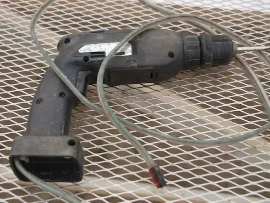

Here is a cord attached directly to a drill. I took the screws out of the case and soldered directly to the terminals that make contact with the battery. I then drilled two holes in the end and used a tie-wrap as a strain relief. This sort of mod is irreversible and permanent -- you can no longer use the OEM batteries with this drill:
Here is a cord attached directly to a drill. I took the screws out of the case and soldered directly to the terminals that make contact with the battery. I then drilled two holes in the end and used a tie-wrap as a strain relief. This sort of mod is irreversible and permanent -- you can no longer use the OEM batteries with this drill.

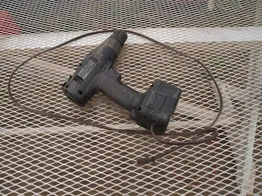

If your tool has an easily disassembled battery, you can modify a bad battery pack instead of the tool, preserving the use of other batteries:
If your tool has an easily disassembled battery, you can modify a bad battery pack instead of the tool, preserving the use of other batteries.

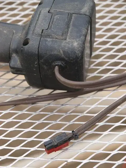

Here is a close-up of a modified battery pack. Note the strain-relief for the cord egress:
Here is a close-up of a modified battery pack. Note the strain-relief for the cord egress.

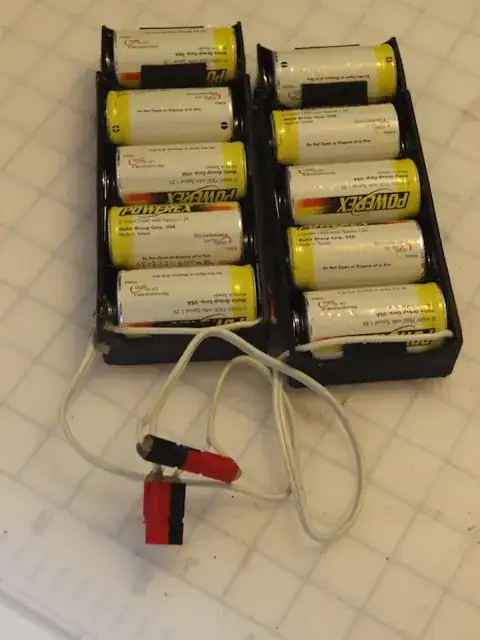

My 10 AH belt-pack is made up of NiMH "D" cells. I have these wired as two six-volt strings that can easily be connected in series, as shown here:
My 10 AH belt-pack is made up of NiMH "D" cells. I have these wired as two six-volt strings that can easily be connected in series, as shown here.
The two six-volt holders then slip into a belt holder designed for a cell phone, a very long time ago:
The two six-volt holders then slip into a belt holder designed for a cell phone, a very long time ago.

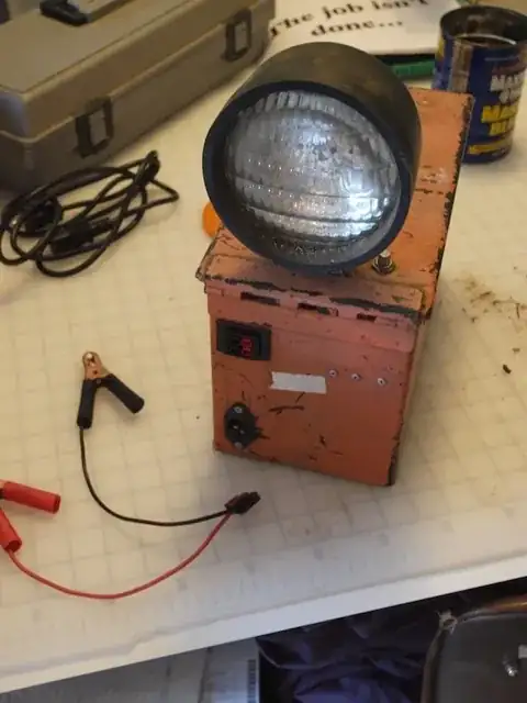

When I need lots of energy, I have a 20 AH battery housed together with a power supply for charging in an army-surplus ammo case. This will run a tool ten times longer than the OEM battery. Included is a trouble light, wired to a relay so that power fails, the light comes on. Shown also is a car battery adaptor to Anderson Power Pole connectors:
When I need lots of energy, I have a 20 AH battery housed together with a power supply for charging in an army-surplus ammo case. This will run a tool **ten times longer** than the OEM battery. Included is a trouble light, wired to a relay so that power fails, the light comes on. Shown also is a car battery adaptor to Anderson Power Pole connectors.
Here is a close-up of the egress to the ammo case. At bottom is a standard connector for a three-pin AC power cord, as used on computers and such. At the top are two pair of Anderson Power Pole connectors in a housing Anderson makes for the purpose:
Here is a close-up of the egress to the ammo case. At bottom is a standard connector for a three-pin AC power cord, as used on computers and such. At the top are two pair of Anderson Power Pole connectors in a housing Anderson makes for the purpose.
