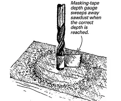

I usually just wrap a piece of masking tape around the drill bit leaving the correct length exposed. You can either wrap enough layers of tape around so that it is fairly thick, or leave a "flag" of tape sticking out. Either way will let you drill to the proper depth without the risk of marking the surface. The metal jaws of a drill can easily damage the surface if you allow them to come in contact.
http://www.finehomebuilding.com/how-to/tips/more-masking-tape-uses.aspx
Dave Nay
  • 1,654
    Beware that if the drill bit is not squeaky clean, the tape will slip. If the drill bit gets warm, the tape will slip. Often, when the tape hits the surface, the tape will slip. – Brock Adams Apr 29 '12 at 22:59
    That is all true, and if I were drilling more than a half dozen holes, I would certainly go with the stop collett. – Dave Nay Apr 29 '12 at 23:04
    I like this solution over using a drill stop simply because it's effectively no-cost (you likely have tape on-hand). I agree with the potential drawbacks mentioned though, so like always, the best solution depends on the exact situation. If you're drilling a couple approximately 1/2" deep holes into a 1" surface, the tape slipping a bit is not a big deal - it's just there to guide you. If you're drilling 50 holes that are all precisely 7/16" deep into a surface that's 1/2" thick, tape (and a hand-held drill) is probably not going to work out very well. – gregmac Apr 30 '12 at 18:06
