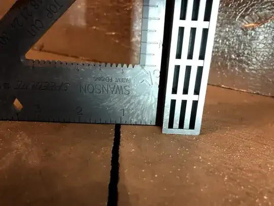

Our home was new construction and the basement floor was poured around 1.5 years ago. The builder installed control joints in several locations in the basement slab. Several of these joints have widened. The widest crack is now around 1/8th inch wide with certain sections as wide as 3/16th inch wide. When i shine a flashlight down this wide section it looks as if i see gravel below although i'm not sure if that is just rough concrete since the floors are supposed to be 4 inches thick.
Is this widening normal? Should i seal these cracks to prevent moisture and soil gasses from getting into the house? control crack in floorpic2pic3

    @bradforj287 I saw the joint with crooked edges as tile. It’s concrete too, isn’t it. So, the good news is that the crooked edge crack was planned, they just did a terrible job of installing it. It’s a “control joint” for expansion and contraction. Fortunately, the joint was installed there to control the cracking. Unfortunately they did not extend it to the top of the slab. So the top cracked leaving a crooked edge. – Lee Sam Jun 26 '18 at 15:02
    @bradforj287 With regard to gasses entering your home: I’d contact your local Department of Environmental Quality or your local Building Department to see if you live where there are RADON GAS. Either way, I’d seal the joint with silicon caulk. (Make sure you get one for floor installations. You won’t find it at your local Building yard.) – Lee Sam Jun 26 '18 at 15:08
    @bradforj287 No, you do not have a claim. There is nothing failing. It’s of reasonable size (I’ve seen them 3/8” wide) and relatively straight. (Failures appear random and at an angle to the home.) – Lee Sam Jun 26 '18 at 15:12

    @bradforj287 Also, when you go to caulk the joint, don’t try to fill the joint up. That is to say, you only need to fill the top 1/8” or so. If you fill it up then it won’t expand and contract and thus fail by tearing away from one edge of the joint. (That looks like what happened in picture 2.) They make backer rods which you can push into the joint to keep a uniform depth for caulking. – Lee Sam Jun 27 '18 at 16:33
