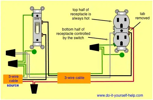

Looking at your pictures, and reading your new comments. Here is what I see, you have a red and black wire attached to your switch and a red and black wire attached to both sides of you receptacle. Are the red and black wires the same wires? Because if they are then where is you hot or source wire?
If you have a voltmeter or a non contact indicator check to see which wires are hot. One attached to the switch and one attached to the hot side of the receptacle should both be constantly hot. The one attached to the switched side of the receptacle should be hot when the switch is turned on. You are right in saying it should be fairly straight forward. I have attached a sketch. enter image description here
Remember your taking reading from a live source so stay safe and good luck.
