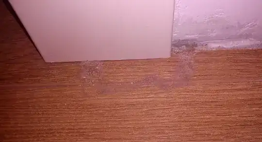

Edit: here are some pictures. First, the glued part. In the picture it looks much worse than in real life (also ignore the lack of skirting board). The glue goes all around the piece since there were some gaps in all directions and as I said, it is barely noticeable from standing height: Glued laminate

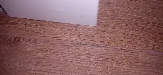

Here the opposite side of the doorway, where the piece is clicked. Note that the central part (piece 2) goes well under the door frame: "Click" laminate
