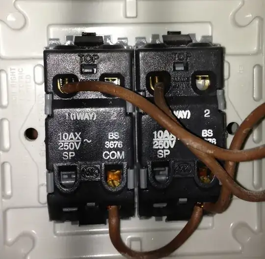

Here's my original light switch setup:
The back of the switch

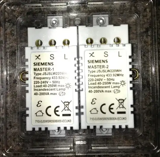

Here's the new LightWaveRF switch:
The back of the dimmer

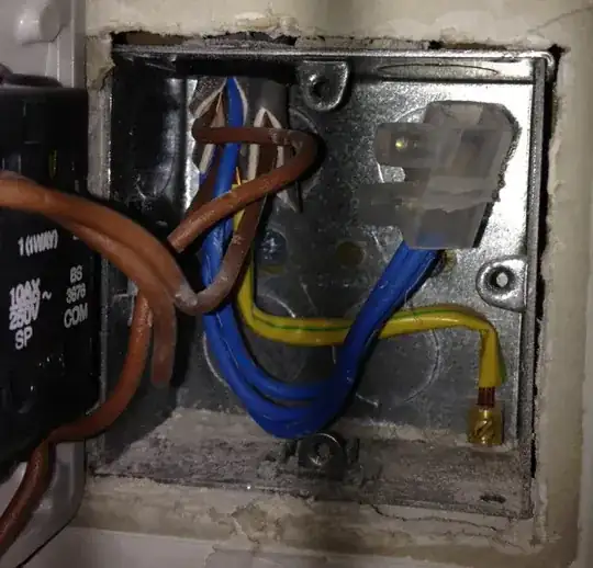

Here's what's in the wall (just in case we need to use these!)
The rest of the wiring

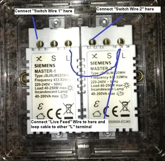

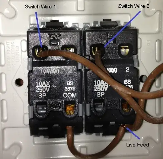

I have included two images. The first identifies the wires in your current switch and the second image identifies where to put said wires.
In case your wondering the "S" terminals are for slave units
Annotated switch image
Annotated dimmer image
