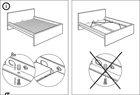

Yes. You can use slats instead of a box-spring. It will be a LITTLE bit stiffer, but it's perfectly fine and you'll love how your bed squeaks less. Here's a pic from an Ikea bed frame assembly guide - just as an example:

  • And add some type of thin board over the slats as suggested in the other answers. – Ken May 16 '12 at 18:02

Slats are typically used with mattresses that don't have springs (coils). If you want to go the slat approach and have a mattress with springs, I'd strongly suggest using a thin yet strong sheet like material over the slats. Something like plywood or faux wood paneling.
Take these concepts into mind whilst building your new frame and you should be perfectly fine without a traditional box spring.
