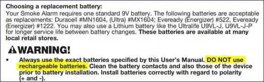

You should use only the batteries recommended by the manufacturer of the detector, and all of the hard-wire w/battery backup models I have experience with expressly forbid the use of rechargeable batteries:

  • Thanks Jimmy. I'll have to see if I can find the manuals online somewhere for the hardwired units. I wonder why some don't want you to use rechargeables. Do you know? – End Anti-Semitic Hate Jul 18 '18 at 02:24
    I would not be at all surprised if they don't want you to use rechargeables simply because some people would, incorrectly, assume that the smoke detector will actually do the recharging and think they never need to change (or recharge) the batteries. Of course for an extra $ they could build a recharging circuit in (like in a cordless phone or many other devices) and solve all the problems. But $1 for the circuit and $1 to include a rechargeable battery and now they are $2 more than the competition... – manassehkatz-Moving 2 Codidact Jul 18 '18 at 02:28
    I agree with @manassehkatz as for the reasoning against rechargeables but will add that anecdotal info I got from searching around seems to indicate that normal alkaline batteries have a slow tapering voltage drop curve, whereas NiMH and NiCd batteries have a rather steep drop, meaning that they go from functional to non-functional quickly, at end of life. – Jimmy Fix-it Jul 18 '18 at 03:09
    There is also the factor that most rechargeables have excessive self-discharge for a low drain application such as a smoke detector -- it's just not worthwhile given how much life a modern alkaline gives in such an application. – ThreePhaseEel Jul 18 '18 at 03:52
    @RockPaperLizard **Because it hasn't been tested for that**. This isn't China. First the manufacturer must do an engineering cycle or two with company testing. Then they must write up labeling and instructions and send it to **Underwriter's Laboratories** or similar lab, where it must survive third party testing. Why would they pay for all that just for your corner case, when their preliminary testing certainly showed what ThreePhaseEel is saying: it's a mistake and a waste of time. When the battery self-discharges in 2 months and starts beeping, who'll the consumer blame? – Harper - Reinstate Monica Jul 18 '18 at 15:39
